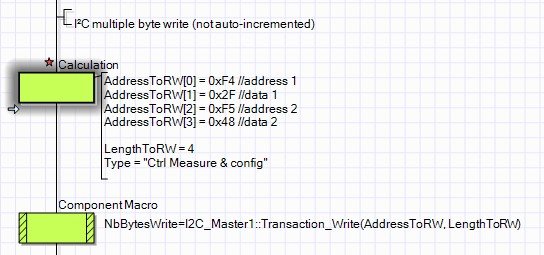

hi,
Is it possible to write 2 values to 2 different address with only one transaction write ?
for example: write 0x2F to 0xF4 address then Write 0x24 to 0xF5 address
thx for your prompt reply

Re: I2C can not read more than 20 data in one time
hi,
It tried I²C multiple byte write (not auto-incremented) and it work well. address 1 to write is the 1st byte of AddressToRW and data is the 2nd byte
address 2 to write is the 3rd byte of AddressToRW and data is the 4th byte
auto-increment is not working with my device
