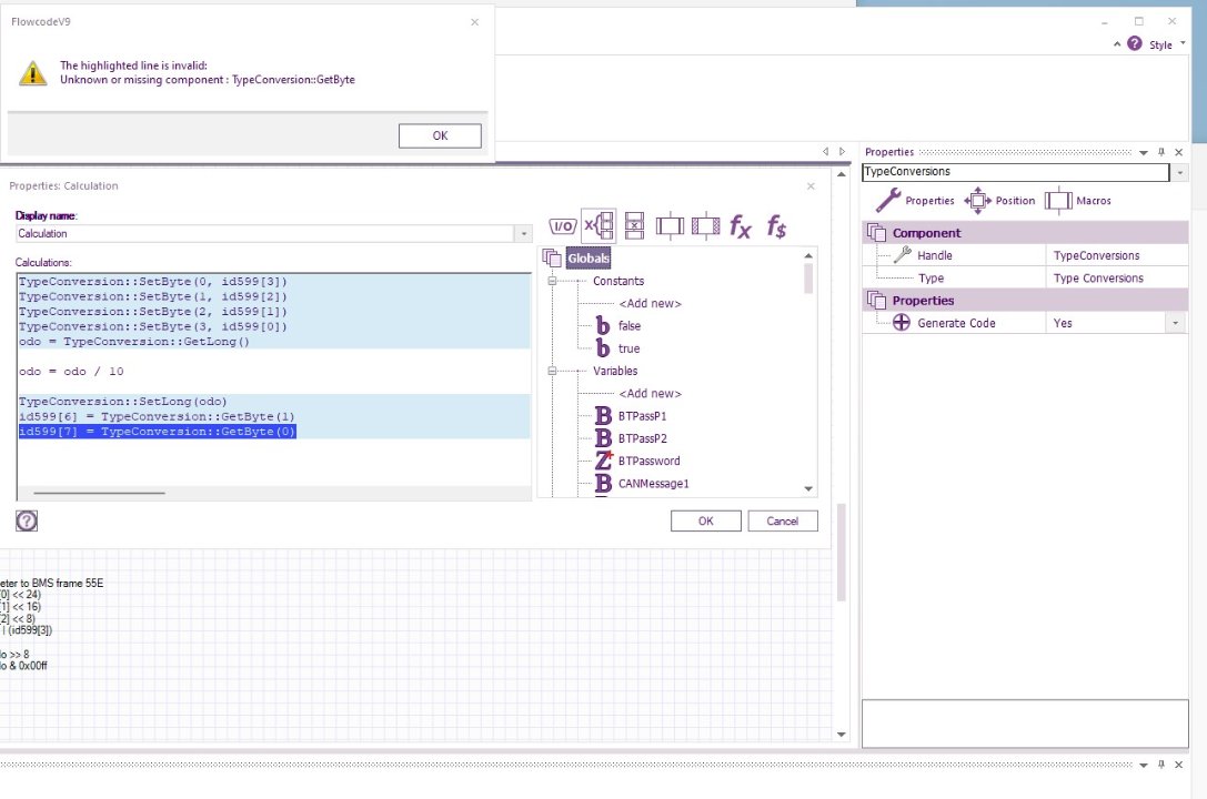

Thanks Ben, I have added the TypeConversion component but get this error message in the Calculation
- TypeConversion.jpg (91.96 KiB) Viewed 6126 times
kennethnilsen69
- Posts: 45
- Joined: Wed Dec 02, 2020 11:41 am
- Been thanked: 3 times
Re: Converting a program from Arduino to Flowcode help.
I figured it out Ben. I was just missing an s at the end of in TypeConversion's name
