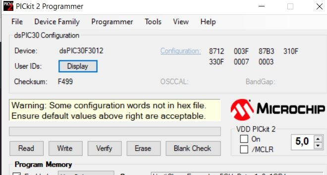

many thanks for the reply. You are right that FBS and FSS have reserved status (not used)
But if the file arrives at a programmer like PIC Kit2 FGS and FICD registers were shifted to FBS and FSS. Please see picture below.
BR
Dirk
