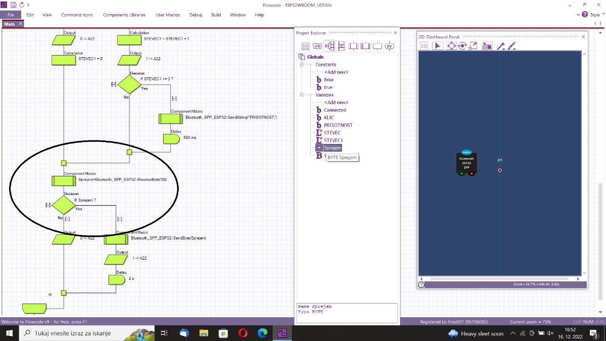

II'm new to Flowcode and having beginner's problems.
I read the input of the letter via the Bluetooth connection on the ESP32 and when I get the information that the letter is "z", the routine should be executed, otherwise it is not. How to solve?

In your decision you can check if the byte received is equal to 'z' note the single quotes around the character to signify it's a single byte.
Decision
var = 'z'
