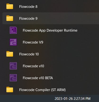

I tried the new version FC10.
Embedded and App developer. Both works fine. Especially the many new panels are great. I have still one question. The FC9 had an App Developer Runtime. Are these also available again for FC10?
Runtime FC9

Re: App Developer Runtime
Hello Stefan,
Yes it's still there just looks like there isn't a start menu shortcut for it this time.
It lives here by default.
C:\Program Files (x86)\Flowcode v10\App Developer
