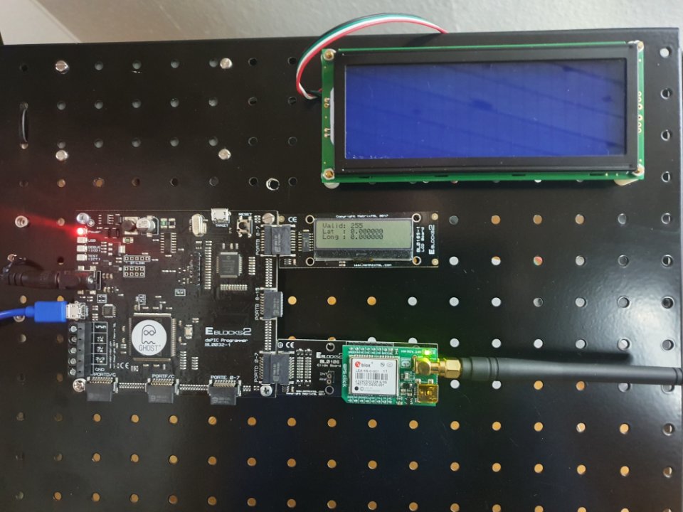

Hi BenR
Thank you very much for helping me with suggestions to get the dsPIC_BL0032_GPS and LCD (BL0169-1.
But I can't see any (Lat , Long) coordinates in the Display.
See the picture below!
dsPIC_BL0032_GPS_and LCD.jpg (167.2 KiB) Viewed 5057 times
Properties BL032.jpg (82.21 KiB) Viewed 5051 times
I have tried according to your description.
But can't see any coordinates in the display.
I have tried exactly according to your instructions but without success.
Yours sincerely
Monie

I have not been able to reply to your post until now, as the FORUM and the entire Flowcode website have been shut down.
But your suggestion works fine for me. I also discovered that the cable for the GPS Antenna was defective.
But when using another GPS antenna, your Flowcode coder works very well fine.
Thank you very much for the help:-)

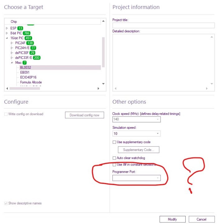

I can't find the Programmer Port on the BL0032. Please see below!
Would you be helpful with a suggestion?
BL0032:
User: Eblocks2 dsPIC Programmer BL0032-1
Flowcode Test Menu-001:

Hi Monie,
Please can you follow Chipfriers great advice and if you are having problems getting it to work then please can you attach your project file so we can see what you have tried and maybe suggest things to try.
BL0032 doesn't need a programmer port and so it is greayed out, when you click compile to chip it calls on the mLoader software packaged with Flowcode. For it to work you do need to have the USB drivers installed.
https://www.flowcode.co.uk/old_site/resources/fil ... rivers.zip

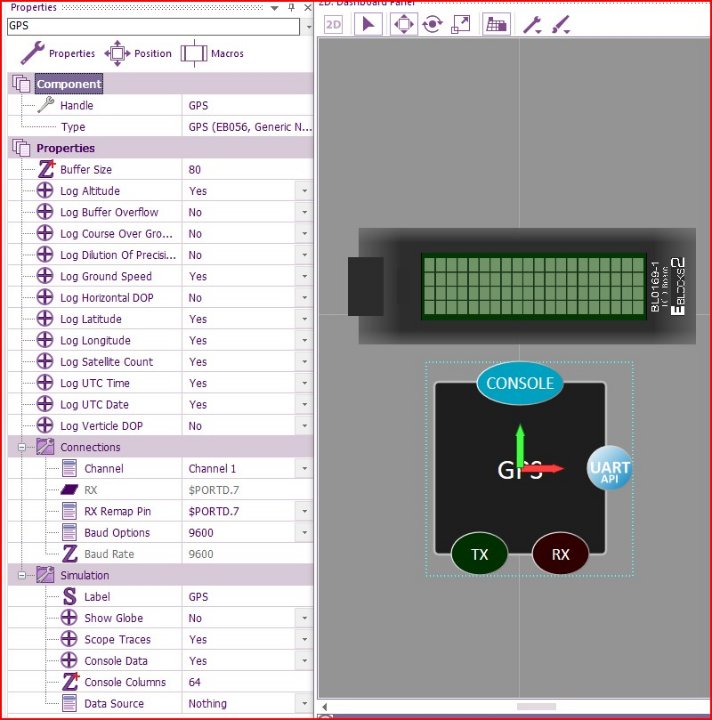

I've resized your panel components a bit for v10 and noticed that the connections for the GPS and the Keypad might not be correct.
Please can you go into the component properties and just check they look ok.
Flowcode Test Menu-001.fcfx
