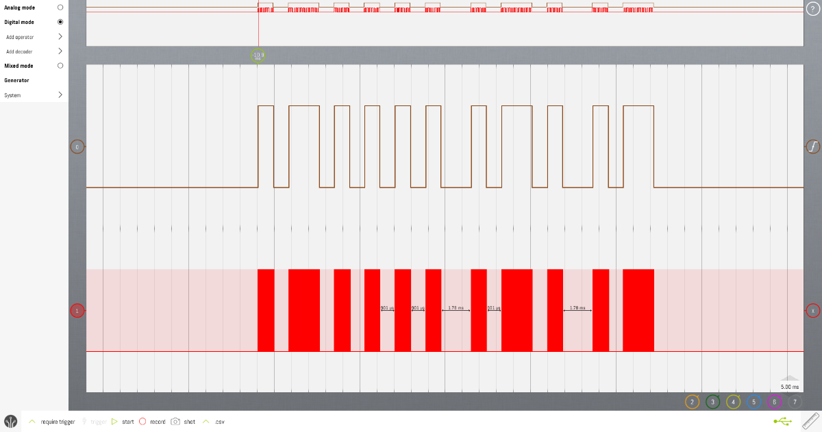

I actually posted this program as a sample in the BUG section. But if we can do something with it... that would be excellent!
The display isn't showing data; it lights up at the start of the program—just as a test to confirm it's taking readings—and I connected an LED to pin A2 to indicate when the RC5 detects incoming data, so the display should show it if that happens.

Do you have a logic analyser or a scope?
