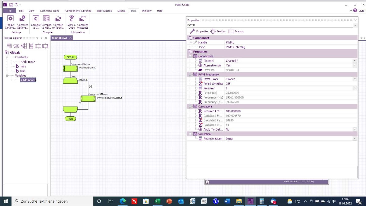

I belive I found a Bug in the PWM component with PIC18F2520.
If you assign PWM Channel-2 to the alternate port (Port B3), the hardware is not giving you the PWM signal
Channel-2 Port C1 is OK
Channel-1 Port C2 is OK
Attached the FC file:
PWM Check.fcfx
(8.07 KiB) Downloaded 257 times
Foto too:
PWM Problem.jpg (120.66 KiB) Viewed 3214 times
It would be great if some one could fix this issue.

Hi Dirk,
If you go into the Build -> Project Options then look at the Configure section there is a setting marked CCP2 Mux, You need to change this from RC1 to RB3.
Hopefully this will get things working for you.

Hi Ben,
many thanks!! You saved my day!!
This is the solution.
