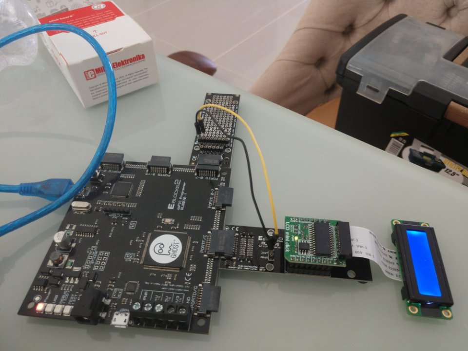

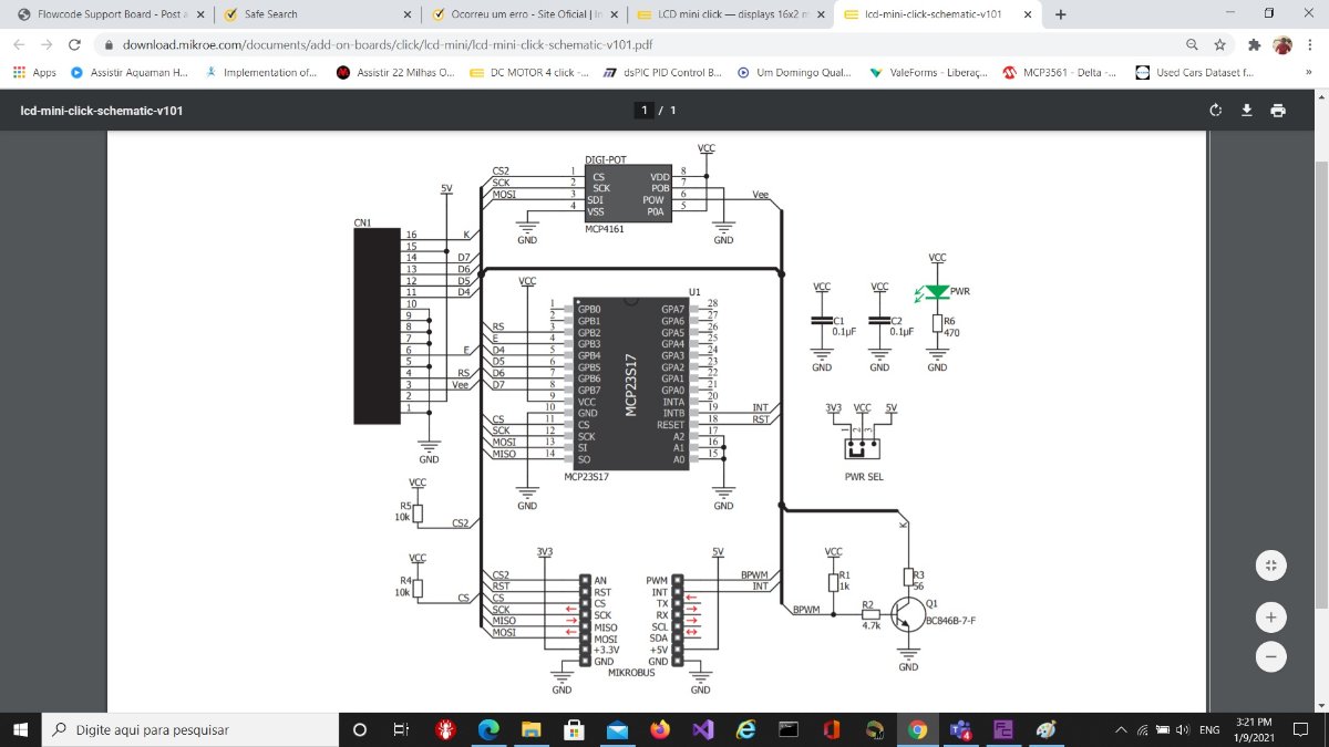

Hi Benj thanks for the component. I tried to do a simple hello world with the following configuration. Maybe im doing something wrong but I could not get the message printed on the lcd. The connections of the eblocks2 (BL0106) and lcd mini click are kind of trick when I tried to follow the schematic picture attached. For example, the interrupt and analog pin available at the bl0106 are related to a digi-pot mcp4161 and its connection is not free on the component implemented (LCD Mini). The (CS2) and Int pins are connected on the Digi pot and on the msp23S17 rescpectively as you can see on the picture.
I Appreciate any help
Rod

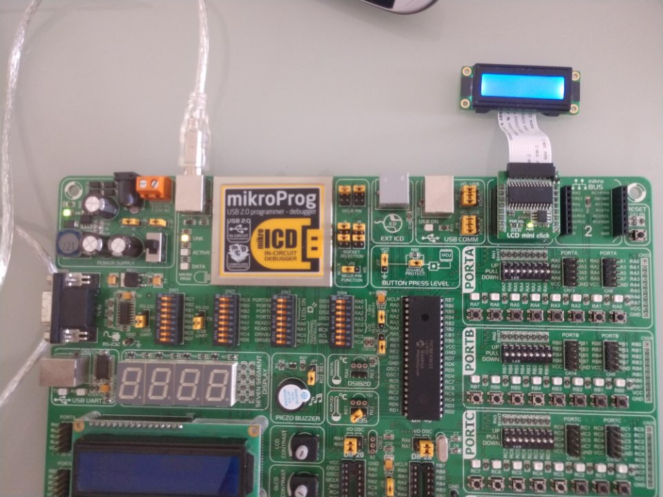

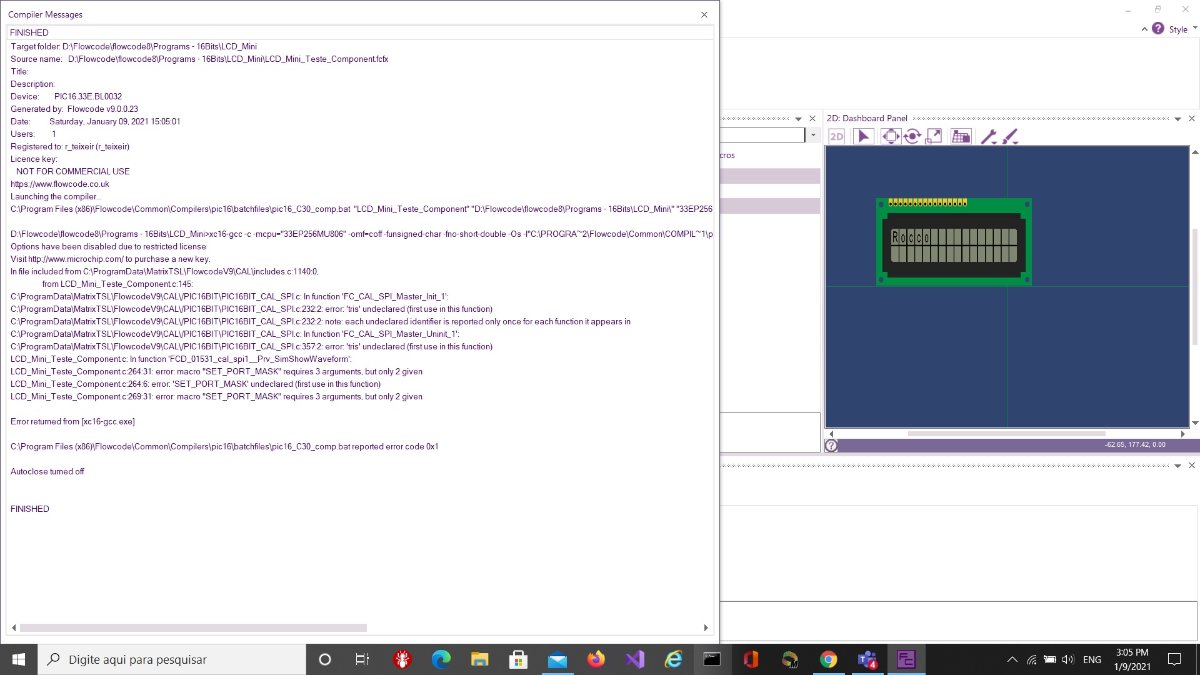

Hi Benj, this time i moved to another hardware, 8 bits. The hardware adresses for spi com is solved during configuration. I included other components to check if would work, but no success. Any help would be appreciated.
Thanks Rod
