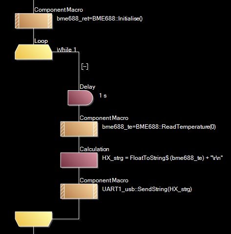

I've started work on a component to go with this module and here is the code I have so far based on the code from the datasheet. I thought it best to share the source and then you can adjust it to your requirements and hopefully together we can build in the functionality and iron out any bugs.
I'm using one of my interface boards to allow me to communicate to the module directly from within the FC simulation saves compiling and programming for every change and addition.
https://www.instructables.com/Universal ... ace-Board/
You could use another API SLAVE target to do the same by replacing the component for another API component e.g. the Arduino Uno. Don't forget the I2C pull up resistors.
https://www.flowcode.co.uk/wiki/index.p ... ve_Devices
You could of course simply compile the code for a MCU as usual instead. It might be interesting to see how the various floating point calculations handle on the various embedded platforms.
I've currently only done temperature, pressure and humidity sensing macros but they seem to be giving sensible values.
Have a look and see what you think.

Right I've gotten the component a bit further now so it can now set the temperature of the hot plate and do a gas resistence reading. I've exported the component and pushed it to the update system.
Let mw know how you get on if you have a go.
