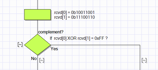

Re: bitwise invert/complement?
XOR (or '^' ) doesn't work correctly either.
The attached fragment returns true.
Jan
Jan
- xor.PNG (20.78 KiB) Viewed 7494 times
- Posts: 2142
- Has thanked: 173 times
- Been thanked: 993 times
It seems to need the brackets (see my sample)
(Sorry - I didn't include this in the description - but I did in the sample)
Must be an operator precedence issue with a non 0 result (possibly (rcvd[1] & 0xff) ^ rcvd[0])
Needs:
Works correctly with them in place....
Needs:
(rcvd[0] ^ rcvd[1]) = 0xFFWorks correctly with them in place....
