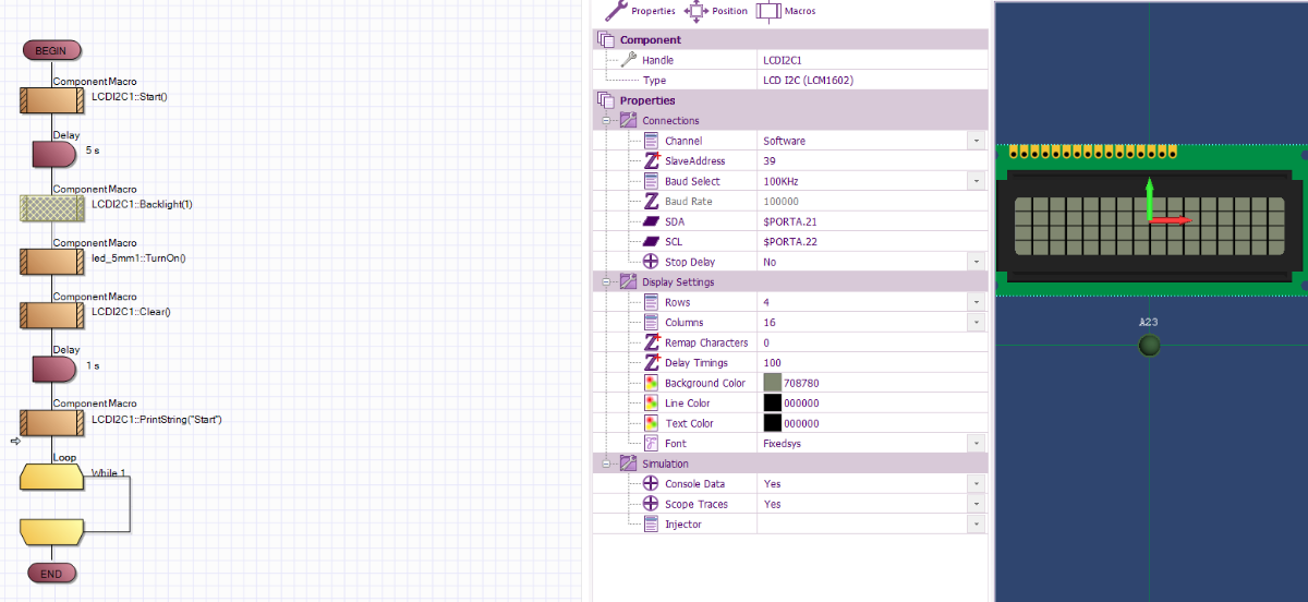

i suspect that there is a problem using display 16x4 (also 16x2) I2C and ESP32 in real hardware (simulation ok).
When start circuit display backlight go off and writing is ok but very slow; i have test all configuration of I2C but only partially working is software mode other not....

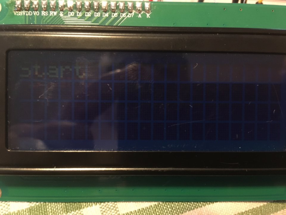

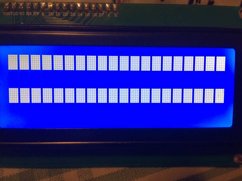

Hi BenR,
in attachments You can see display before start program and after launch program with string "Start" composing slow and backlight down...
Display is 2004 I2C SUNFOUNDER.
