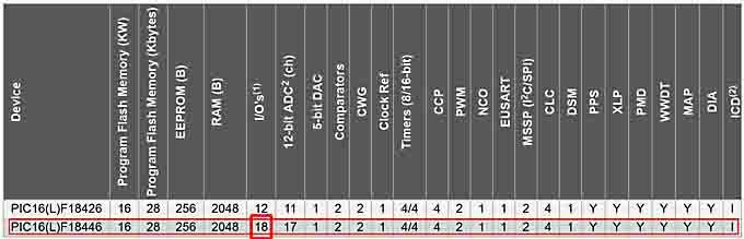

Yes... Off course ... I didn't noticed I wrote the wrong PIC name .
Sure it's about the 16(L)F18446 .
This uC is available only in a 20-pin or higher pin count because it has 18 IO pins .
Screenshot 2022-06-11 181444.jpg (47.65 KiB) Viewed 3954 times
So, Flowcode should have IOC on Port-B for this uC .
Many thanks in advance,
Miguel Garcia,
Electronic Systems Developer

Re: PIC16(L)F18446 missing PortB IOC on Interrupt Icon Properties
Post by chipfryer27 »
I appear to need new batteries in my calculator as I seem to have miscounted the pins on the "46" :)
It does look like it should have Port-B IOC capabilities and is probably just an oversight as you suggest.
