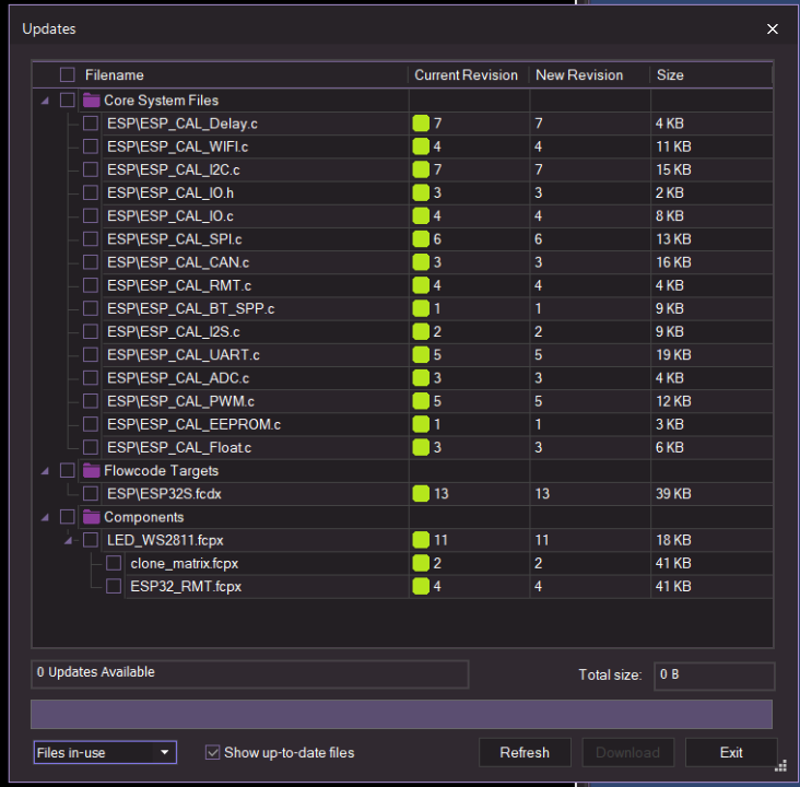

Have you done a full database update it looks like maybe the rmt component is maybe not fully up to date.
I'll do some tests here and double check everything is OK at this end.

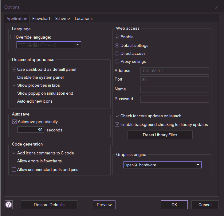

If you mean the component library, yes I prefer always to do all the updates from the complet library.
Or do I have to reset the component library?
