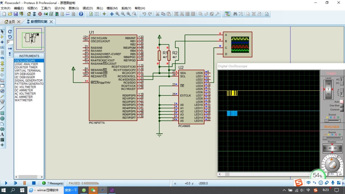

PCA9685 Why not work? What went wrong? Please help me!

Still won't do.Can you give me an example? For example, light up LED0, LED3, etc.thank you!

Ran the simulation according to your program, and it still doesn't work. Can you send up the LED flashing program you made? thank you

I do not use Proteus so cannot help with your simulation.
