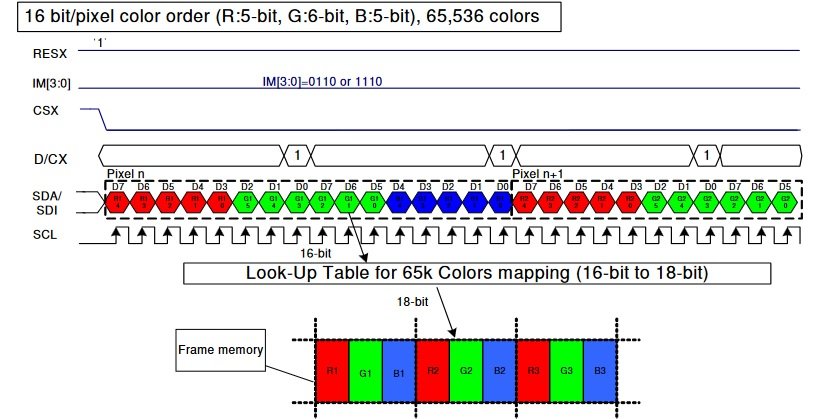

Looking at the component code it seems to correspond to the datasheet where it first sends red (MSb), then green and then blue (LSb) for each pixel.
It could be the display manufacturer has wired up the blue LEDs to the red channel. I'll add in a property to allow the colours to be switched.
