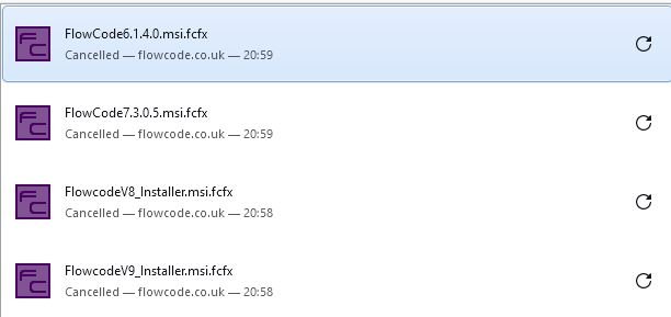

Tried to download FC again to reinstall. However when I try to download the msi file using Firefox I am apparently downloading FlowcodeV9_Installer.msi.fcfx which of course plays havoc as FC then tries to open it instead of Windows running it.
Same if I try to download any other FC version, the .fcfx is added during download.
This only happens with Firefox. Any ideas?

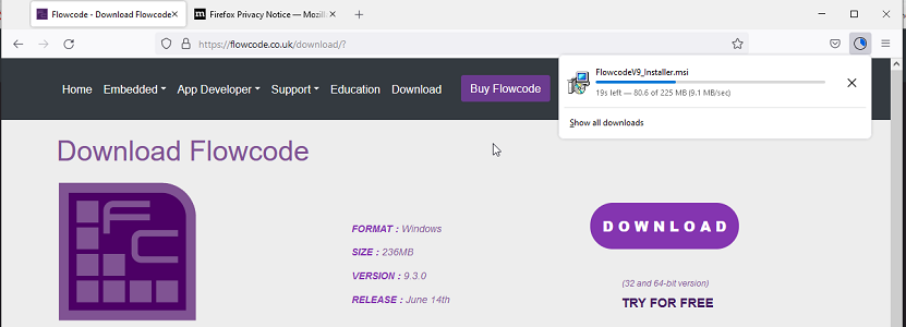

That is very odd as I have just installed firefox to try and:
Firefox V9 download.png (70.84 KiB) Viewed 1768 times
Does this help you?

It's only started doing it. I've been going through the web looking for ideas and apparently similar issues have been going on for quite a while with no "one size fits all" fix.
So far no joy...
Tried changing a few settings but no luck, I still get
It did update itself a few days ago so.....
Tempted to just uninstall / reinstall but might look a bit longer for a fix.
