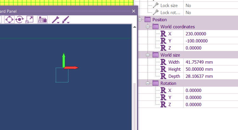

I try to test the SK6812 RGBW component. When I added the component to the 2D or 3D dashboard panel it is not possible to se the led. If I with luck am able to click on the component on the dashboard I am able to see the properties and try to increase the size with and high nothing happend. What am I doing wrong please?

It appears to be a v9 bug. It works fine in v8.
I created a 1Dx 10 string in v8, saved and then opened in v9. I had to mess around with properties to get it displaying. Hopefully the attached will be of some use.

Had a further play. In v9 if you add the component then go to Project explorer and click on components, highlight the SK6812 and right-click-select the component will show in the panel, Well the positioning bars will. If you now go to the component properties and set Column Spacing to 1 then on mine at least you will see a string on the panel.

I think I've fixed it properly now so it should correctly appear when you drag it on.
I've also updated other similar components as they had similar issues.

Seems to work OK now.
