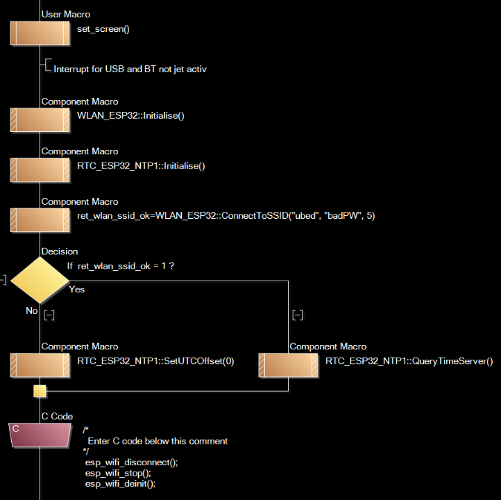

We can certainly look at adding a disconnect macro. Does the following C code do what you need?
esp_wifi_disconnect();
esp_wifi_stop();
esp_wifi_deinit();-
- Posts: 1287
- Has thanked: 246 times
- Been thanked: 257 times
Re: ESP32 Real Time Clock faild
Yes it's working fine.
If the password is correct it's set the time (with 2hours offset)
If the password is bad it's set the time to 00:00:00 ( 2hours offset is set to 0)
Always the HX711 is working nice.
These 3 commands could also be useful for other applications, if it is not too complicated I would add them to the component.
But for me it's already perfect.
