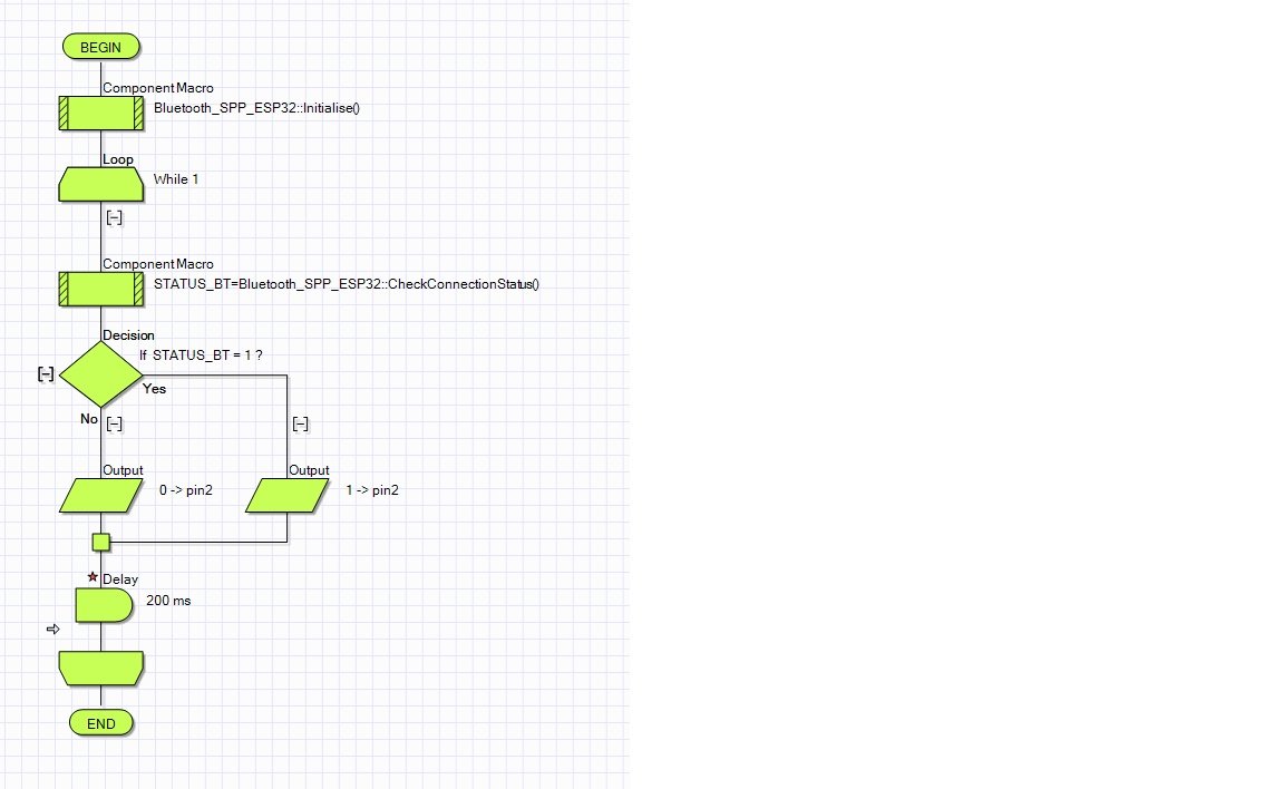

Hello again, I changed sdkconfig file from my project and now the compiler doesn't show the mistake, so now the code seems correct.
However if try to test the example doesn't work.
My example is very simple, attach file.
You can see in my example, only initialise module BT and check status only. If status is connected led pin 2 (ON), if not connected led pin 2 (OFF)
Very easy but doesn't work.
Thanks and regards.
Thanks and regards.
- EASY_CHECK_BT_ESP32.jpg (70.19 KiB) Viewed 56238 times
