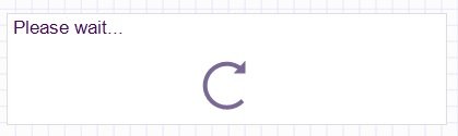

Save the current 2D Dashboard Panel as image causes App Developer to freeze.
App Developer freezing [Resolved, not freezing]

I've tried to replicate and it appears to be working fine for me. Is it with a specific project or component? Please post or PM with the project you are having the issue with and I will try to fix.

I've tried with that project and all export formats work, but the "mesh" export takes a very long time. I cannot replicate Flowcode freezing. Was there a specific image format that causes the freeze for you?
All image file formats are exported quickly, but they do not show the image (this is a known issue with some of the objects on the 2d panel - e.g. charts, gauges).

Re: App Developer freezing
Hi Steve, thanks.
I have just tried again and been more patient.
After 4 minutes on my PC, App Developer still not responding, hence thinking its freezing.
It took 6 minutes and indeed not freezing but a very long time like you suggested.

Re: App Developer freezing [Resolved, not freezing]
Thanks, Martin.
So you are aware, I've rearranged the file formats when saving an image so that the "mesh" is last (and "png" is the default).

I wanted to import a simple 3D object into the App Developer (just a cube).
It had also taken several minutes. Flowcode was like frozen.

When importing an object flowcode pops up a window with the import properties. This window often appears behind the main Flowcode window and so it looks like Flowcode has crashed displaying Please Wait.

Yes I have see that and threw me the fist time.
It was as Ben suggested.
The pop up window was behind Main Window.
As soon as I spotted that, it was all good.
