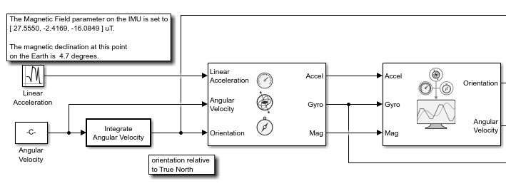

We try with Flowcode to create an IMU Sensor Fusion.
acceleration (Accelerometer), angular velocity(Gyroscope) and maybe orientation (Magnetometer).
for this a matrix and integral would be useful.
We are aware that this means some effort for us.
