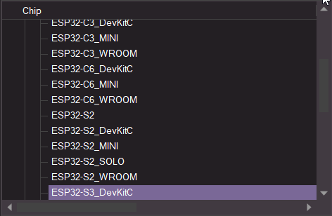

I have also tried the esp32-S3 and compiling works. But there is an error message while "flashing"
idf.py build
Target: esp32s3 ...
Target 'esp32s3' specified on command line is not consistent with target 'esp32s2' in CMakeCache.txt. Run 'idf.py set-target esp32s3' to re-generate CMakeCache.txt.

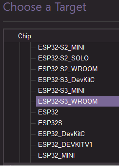

On my board is an ESP32-S3FN8.
I don't know exactly which S3 I should choose. I have tried them all...
