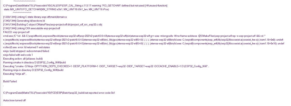

I have got a project in FC10 that doesn't use the ESP WLAN component.
This compiles like it should.. it works fine.
I add a ESP WLAN component to it and it compiles without errors.
I initialise the ESP component with the component macro and it doesn't compile anymore.
There are a lot of error like this:
I don't know if I've ever experienced this. I don't know where to start searching.
Any ideas?
I've tried this with a project that compiled OK in FC9 and this shows the same errors.
Tried it with an example for the FC Wiki... same compiling errors..
Is there something wrong with the ESP WLAN component?

                 from D:/FC10/ESP/Clock/main/esp-project.c:49:
C:\ProgramData\MatrixTSL\FlowcodeV10\CAL\ESP\ESP_CAL_String.c:795:18: warning: 'FCI_STRMOV' defined but not used [-Wunused-function]
 static MX_UINT16 FCI_STRMOV(MX_STRING sSrc, MX_UINT16 iSrc_len, MX_STRING sDst, MX_UINT16 iDst_len)
C:\ProgramData\MatrixTSL\FlowcodeV10\CAL\ESP\ESP_CAL_String.c:771:18: warning: 'FCI_STRREV' defined but not used [-Wunused-function]
 static MX_UINT16 FCI_STRREV(MX_STRING sSrc, MX_UINT16 iSrc_len, MX_STRING sDst, MX_UINT16 iDst_len)
C:\ProgramData\MatrixTSL\FlowcodeV10\CAL\ESP\ESP_CAL_String.c:701:17: warning: 'FCI_STRING_TO_FLOAT' defined but not used [-Wunused-function]
 static MX_FLOAT FCI_STRING_TO_FLOAT(MX_STRING String, MX_UINT16 MSZ_String)
C:\ProgramData\MatrixTSL\FlowcodeV10\CAL\ESP\ESP_CAL_String.c:598:18: warning: 'FCI_NUMBER_TO_HEX' defined but not used [-Wunused-function]
 static MX_STRING FCI_NUMBER_TO_HEX(MX_ULONG Number, MX_STRING String, MX_UINT16 MSZ_String)
C:\ProgramData\MatrixTSL\FlowcodeV10\CAL\ESP\ESP_CAL_String.c:531:18: warning: 'FCI_FLOAT_TO_STRING' defined but not used [-Wunused-function]
 static MX_STRING FCI_FLOAT_TO_STRING(MX_FLOAT Number, MX_UINT8 Precision, MX_STRING String, MX_UINT16 MSZ_String)
C:\ProgramData\MatrixTSL\FlowcodeV10\CAL\ESP\ESP_CAL_String.c:476:17: warning: 'FCI_COMPARE' defined but not used [-Wunused-function]
 static MX_UINT8 FCI_COMPARE(MX_STRING sSrc1, MX_UINT16 iSrc1_len, MX_STRING sSrc2, MX_UINT16 iSrc2_len, MX_UINT8 iNoCase)
C:\ProgramData\MatrixTSL\FlowcodeV10\CAL\ESP\ESP_CAL_String.c:450:13: warning: 'FCI_TOUPPER' defined but not used [-Wunused-function]
 static void FCI_TOUPPER(MX_STRING sSrc, MX_UINT16 iSrc_len, MX_STRING sDst, MX_UINT16 iDst_len)
C:\ProgramData\MatrixTSL\FlowcodeV10\CAL\ESP\ESP_CAL_String.c:424:13: warning: 'FCI_TOLOWER' defined but not used [-Wunused-function]
 static void FCI_TOLOWER(MX_STRING sSrc, MX_UINT16 iSrc_len, MX_STRING sDst, MX_UINT16 iDst_len)
C:\ProgramData\MatrixTSL\FlowcodeV10\CAL\ESP\ESP_CAL_String.c:331:10: warning: 'FCI_TOSTRU32' defined but not used [-Wunused-function]
 MX_UINT8 FCI_TOSTRU32(MX_UINT32 iSrc1, MX_STRING sDst, MX_UINT16 iDst_len)
C:\ProgramData\MatrixTSL\FlowcodeV10\CAL\ESP\ESP_CAL_String.c:297:10: warning: 'FCI_TOSTRU16' defined but not used [-Wunused-function]
 MX_UINT8 FCI_TOSTRU16(MX_UINT16 iSrc1, MX_STRING sDst, MX_UINT16 iDst_len)
C:\ProgramData\MatrixTSL\FlowcodeV10\CAL\ESP\ESP_CAL_String.c:254:10: warning: 'FCI_TOSTRS32' defined but not used [-Wunused-function]
 MX_UINT8 FCI_TOSTRS32(MX_SINT32 iSrc1, MX_STRING sDst, MX_UINT16 iDst_len)
C:\ProgramData\MatrixTSL\FlowcodeV10\CAL\ESP\ESP_CAL_String.c:211:10: warning: 'FCI_TOSTRS16' defined but not used [-Wunused-function]
 MX_UINT8 FCI_TOSTRS16(MX_SINT16 iSrc1, MX_STRING sDst, MX_UINT16 iDst_len)
C:\ProgramData\MatrixTSL\FlowcodeV10\CAL\ESP\ESP_CAL_String.c:182:18: warning: 'FCI_RIGHTSTRING' defined but not used [-Wunused-function]
 static MX_STRING FCI_RIGHTSTRING(MX_STRING sSrc, MX_UINT16 iSrc_len, MX_UINT16 iCount, MX_STRING sDst, MX_UINT16 iDst_len)
C:\ProgramData\MatrixTSL\FlowcodeV10\CAL\ESP\ESP_CAL_String.c:159:18: warning: 'FCI_LEFTSTRING' defined but not used [-Wunused-function]
 static MX_STRING FCI_LEFTSTRING(MX_STRING sSrc, MX_UINT16 iSrc_len, MX_UINT16 iCount, MX_STRING sDst, MX_UINT16 iDst_len)
In file included from C:\ProgramData\MatrixTSL\FlowcodeV10\CAL\internals.c:568,
C:\ProgramData\MatrixTSL\FlowcodeV10\CAL\ESP\ESP_CAL_String.c:129:18: warning: 'FCI_MIDSTRING' defined but not used [-Wunused-function]
 static MX_STRING FCI_MIDSTRING(MX_STRING sSrc, MX_UINT16 iSrc_len, MX_UINT16 iStart, MX_UINT16 iCount, MX_STRING sDst, MX_UINT16 iDst_len)
C:\ProgramData\MatrixTSL\FlowcodeV10\CAL\ESP\ESP_CAL_String.c:113:17: warning: 'FCI_GETCHAR' defined but not used [-Wunused-function]
 static MX_UINT8 FCI_GETCHAR(MX_STRING sStr1, MX_UINT16 iStr1_len, MX_UINT16 iPos)
[3/7] Linking C static library esp-idf\main\libmain.a
[4/7] Generating ld/sections.ld
[5/7] Linking CXX executable esp-project.elf
FAILED: esp-project.elf
cmd.exe /C "cd . && C:\espidftools\.espressif\tools\xtensa-esp32-elf\esp-2021r2-patch5-8.4.0\xtensa-esp32-elf\bin\xtensa-esp32-elf-g++.exe -mlongcalls -Wno-frame-address  @CMakeFiles\esp-project.elf.rsp -o esp-project.elf  && cd ."
c:/espidftools/.espressif/tools/xtensa-esp32-elf/esp-2021r2-patch5-8.4.0/xtensa-esp32-elf/bin/../lib/gcc/xtensa-esp32-elf/8.4.0/../../../../xtensa-esp32-elf/bin/ld.exe: C:/espidf/components/esp_wifi/lib/esp32/libcoexist.a(coexist_hw.o):(.iram1.18+0x0): undefined reference to `btdm_rf_bb_reg_init'
c:/espidftools/.espressif/tools/xtensa-esp32-elf/esp-2021r2-patch5-8.4.0/xtensa-esp32-elf/bin/../lib/gcc/xtensa-esp32-elf/8.4.0/../../../../xtensa-esp32-elf/bin/ld.exe: C:/espidf/components/esp_wifi/lib/esp32/libcoexist.a(coexist_hw.o):(.iram1.18+0x16): undefined reference to `btdm_rf_bb_reg_init'
collect2.exe: error: ld returned 1 exit status
ninja failed with exit code 1
Running ninja in directory D:\FC10\ESP\Clock\build
Executing "ninja all"...
Build Failed
C:\ProgramData\MatrixTSL\FlowcodeV10\FCD\ESP\Batch\esp32_build.bat reported error code 0x1
Autoclose turned off
FINISHED

We've not been able to replicate this but searching the problem I stumbled across this which suggests it's a problem when both WIFI and Bluetooth are enabled but Bluetooth has not been initialised.
https://github.com/espressif/esp-idf/issues/13113
Are you using Bluetooth in your project?
You might be able to go into the menuconfig tool and simply turn off Bluetooth if not.

Thanks BenR, this was the case...
I never enabled the Bluetooth in the menuconfig so this must be a default setting?
This also means that in one project we can never use BT and Wifi at the same time?
Thanks for the quick solution.
Maybe spread the word about this error?
