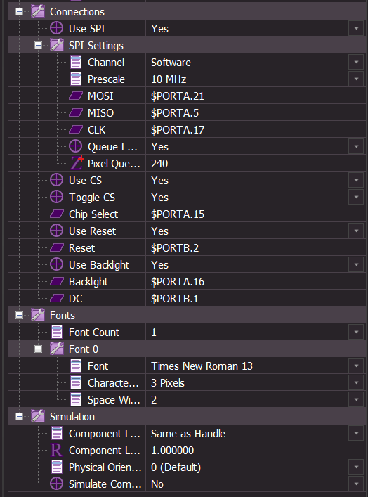

Re: App Developer connect to ESP32 S3 with USB
For the Atom S3 the component gLCD_ST7789V1 is working to display text.

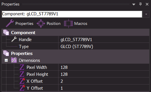

Thank you very much.
The Atom S3 template is working nice.
the display also works,
but I have to set all the pin.maybe you can make a template with a display
Display only in software mode on my computer is compiling.
a new component is SerialPort.fcpx but no info what it is.
and the display makes an offset. i was able to set and correct this with the other driver Set the pin:
