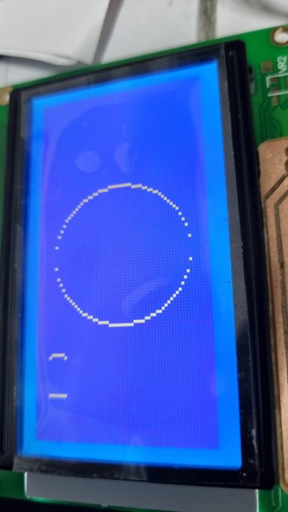

Hi BenR, the SPI Version is almost working, I made an example that draws a circle and writes "HELLO", but the cicle and the characters apears with some parts missing. Can you help me?

It looks like the readback function is not quite right. I've had a look at the component code and found a bug so hopefully it's going to work better now. I've pushed the updated component to the library update system so let us know how you get on.
