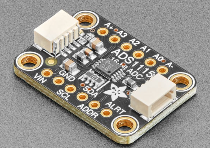

With ESP32 and ADS111x I get a fail.
And there is a pin RDY/ALRT but I just have a QWII connector with SDA and SCL.
https://www.adafruit.com/product/1085

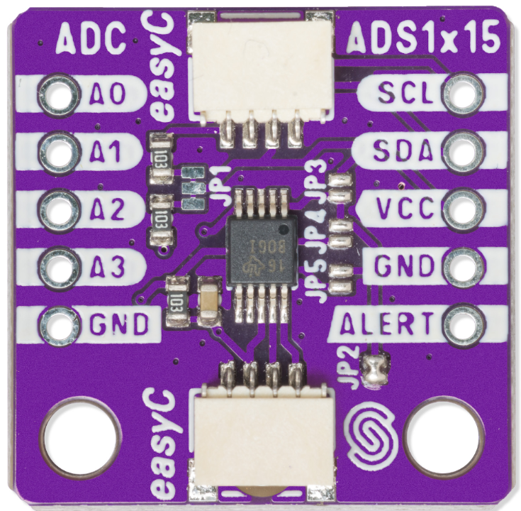

I have found a couple of other boards and will also test the Grove board with the screws
https://www.digikey.ch/de/products/det ... /12340170 https://www.digikey.ch/de/products/det ... 3/9356341
https://www.digikey.ch/de/products/deta ... 5/21720386

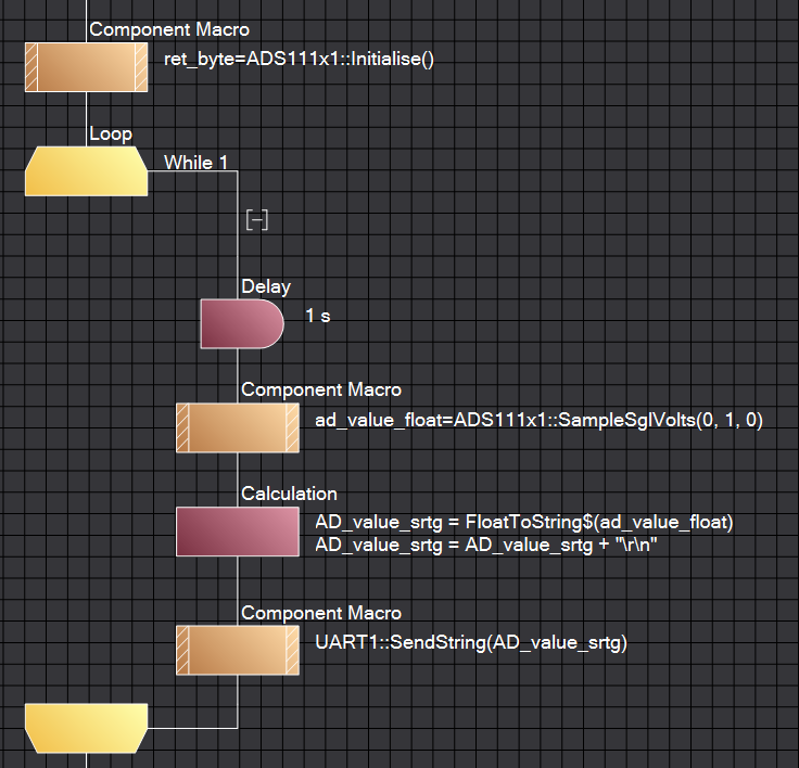

Re: ESP32 and ADS111x Analog to Digital converter fail
Perfect! It's working fine? Thank you.
But..... I have to choose a pin for RDY/ALRT.
If I choose unconnected it's give a pop up warning and it's compiling but not working in hardware
This is my Testprogram: and the nice result, I set it to gnd and later to 3.3Volt and show it in a terminal App
