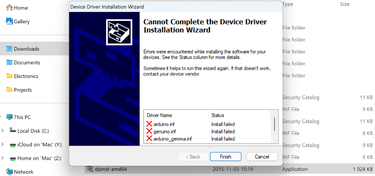

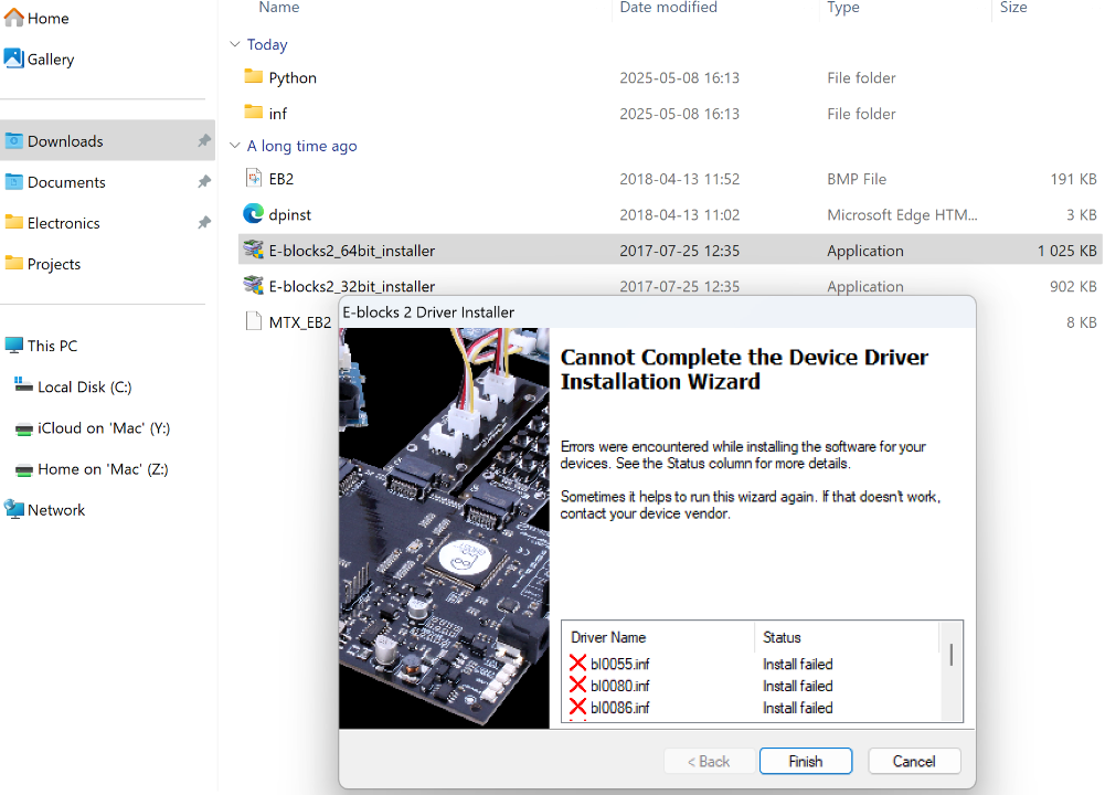

I am unable to install the drivers for the E-Blocks2 BL0055, which I own, or for Arduino, due to the "Install failed" error that I get immediately after I start the setup for both installers on 64-bit architecture:

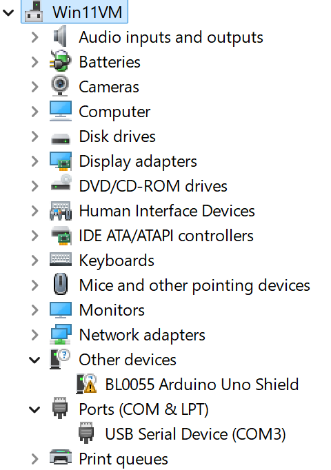

In Device Manager I see "BL0055 Arduino Uno Shield" without drivers because they are not installed.

I also own a Windows 11 laptop, on which I had no problems installing both E-Blocks2 and Arduino drivers.
Does anyone know how to fix this?
I have also tried to "run as administrator," and I get the same upper errors despite already being an admin on my VM.
After restarting my Virtual Machine in Safe Mode, I get the same errors, and the Setup process doesn't work further than those two error screens.
My setup consists of a Windows 11 virtual machine inside Parallels Desktop, because I am a Mac user.
