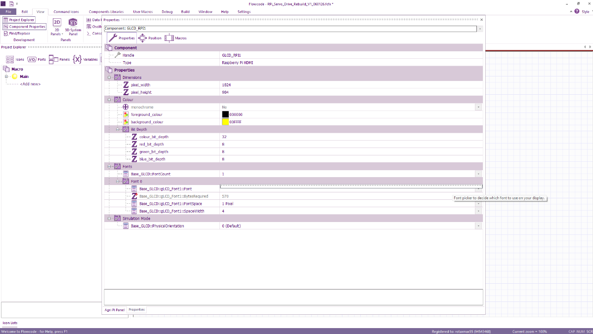

Hi, trying to use the latest GLCD_RPI component, revision 10.
I can't set the 'Base_GLCD::gLCD_Font1::Font' value.
When I click on the drop down option arrow there are no options presented, just a small empty box, previously I had revision 6 installed and this worked ok.
See screenshot attached for appearance:
2026-01-06 (2).png (140.21 KiB) Viewed 3544 times

It seems to be working for me in v10. Can you please try clicking on Help -> Library updates and changing Files in use to Full Database. Download the latest of everything and then close and restart Flowcode and hopefully you will have selectable fonts again for the RPI display.

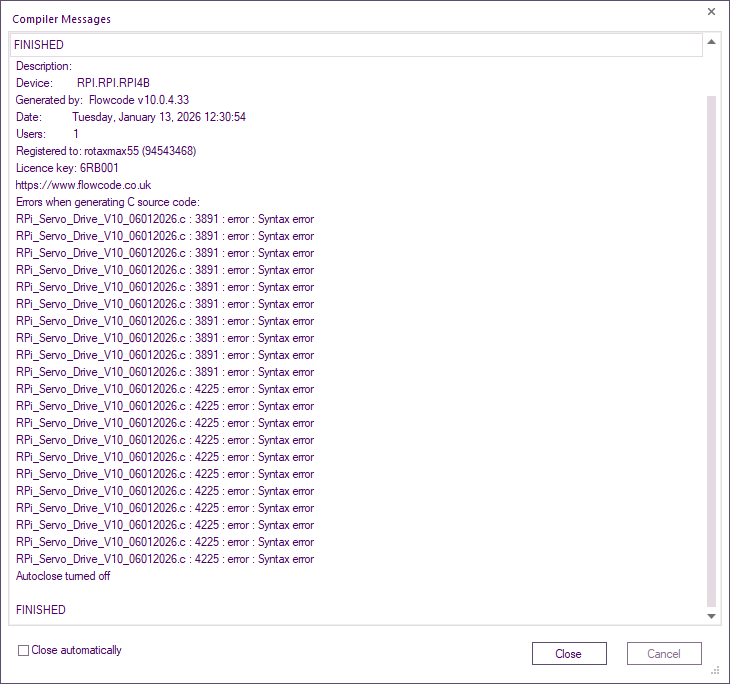

I tried that but now I am just getting compile errors which I can't decipher:
Attached is the source code.

Have you updated your full component database then reloaded your project?
I'm asking as your project also compiles OK for me with FC10

I tried it and it compiles fine for me in FC10.
