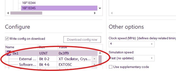

You have the oscillator set wrong in Project Options.
For External Oscillator Mode between 100KHz and 4MHz you should set at XT
Software Oscillator mode should just be EXTOSC (you have it at 4xPLL which multiplies the clock by a factor of four)
Screenshot 2026-01-10 044318.jpg (41.93 KiB) Viewed 2794 times
Hope this helps.

Thank you that has sorted it.
Have to put that down to a late night senior moment!
