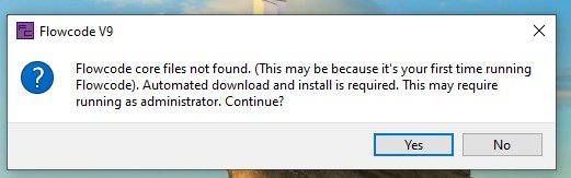

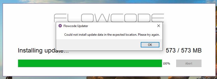

I tried to update my current version of FC v9 today. I could see from the update list that there were 27 updates but, for some reason it stated the files needing updating were not genuine. I tried several times to perform the update to no avail. I have attached some error messages which I hope will help. This is the first time I have had this problem as I have updated quite a few times previously without any issues. ( I am an administrator on my laptop. ) Regards Mark.

The first error message "Could not install update in the expected location" indicates that the Flowcode installer cannot replace the "data" folder of Flowcode. This is under the original installation location. It could be a permissions issue, or could be because Windows is holding one of the files open. Or perhaps another instance of Flowcode is running.
To fix this, I suggest you restart your PC and then run the Flowcode launcher. If this fails to download and install Flowcode then we'll need to investigate further.
The second issue shows some local files as "not genuine". This is because you are still running v9.0 but those files are for v9.1 and the original release of Flowcode cannot determine their status. You should be able to ignore these for now while running v9.0. The messages will go away once you have updated to v9.1.

I assume restarting your PC did not solve it for you.
What about running the Flowcode launcher with elevated privileges? (i.e. right-click the launcher exe or the Flowcode shortcut and select "run as administrator"). This should solve your issue if Flowcode is installed in a location where your account does not have read/write access.

This has been tested on quite a few PCs now, so I'm confused why this issue is happening for you.
I've just uninstalled and reinstalled the original release of Flowcode into the default location. Then I ran Flowcode and said "yes" to the update. At this point, the Windows UAC dialog launched and my user privileges were elevated. The update was then downloaded and installed without issue.
If you are still having problems, then I suggest you try the steps I took above and see if that works.
Please let me know how you get on.

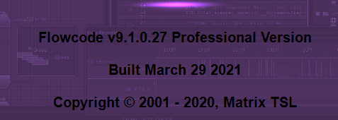

I think I managed to update, I suppose the new update is from 7.0 to 7.1 but where can I see my version please I try to look around in "help" )
Br Jorgen
EDIT. Found it. This migth be the latest version. What I do, run the update, restart the pc and create a new shortcut for the icon startup FC9, and this work for me and could maybe help my other friend´s here
If I have the newest version
Br Jorgen
Br Jorgen
Br Jorgen
