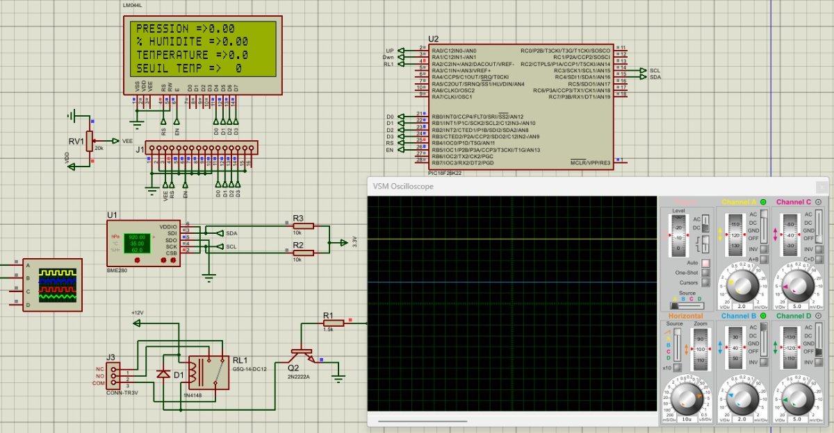

HI All,
Has anyone ever run the BME280 in hardware with a PIC microcontroller?
I ask because the simulation works perfectly in FC11, but it doesn't work in Proteus.
Thanks in advance for your answers.

Well, I connected (and you were right) VDDIO, SDO, and CSB to the 3.3V rail. It didn't change anything. I forgot to show in my previous post that I do have signals on SDA and SCL.
I haven't heard back from Labcenter. I'm going to try to build a hardware circuit (I'm still in a mess from moving, I have boxes everywhere). Thanks again, Medelec, for doing the test.
