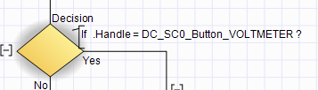

See what you mean with your examble. Vhen I press "Voltmeter" in main Sceneo It shift to
Scene1, but emediately it jump back to Scene0 again, in simulation and also
in "real world on the display. Just like the IF function don´t care the command?
Br Jorgen
Posts: 2269
Has thanked: 626 times
Been thanked: 833 times
Re: Display manager!
Aha sorry the decisions in the DC_Touched were not checking against the .Handle variable and so were always true.
They should have looked like this.
Screenshot 2026-03-04 104748.png (10.51 KiB) Viewed 6013 times
Should be fixed now.
DisplayCreatorSelf2.fcfx
(41.43 KiB) Downloaded 1140 times

Post by jgu1 »
Hi Ben!
No sorry
Perfect :D
Many many thank´s, now it work, why have I overseen this. Now I can take next step and continue. As I mention, there are many advantages with Disp.manager.
