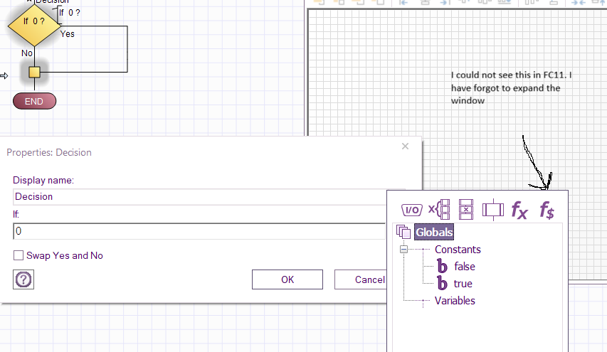

In FC10 it is possible to to call/add the compare string from the If decision (f§) in the drop down list, it is not visible in F11, I have to add a Calculation box and find it this way?
Jorgen

jgu1
Posts: 947
Location: Denmark
Has thanked: 871 times
Been thanked: 212 times
Re: Compare strings!
Post by jgu1 »
Hi Ben!
Sorry, I am not so good to explain. I think if you look at the att picture you see what I mean I could not see the " F§ " in FC11 I have not expand the window in FC11 :lol:
Sorry for the inconvenience :) and thak´s
