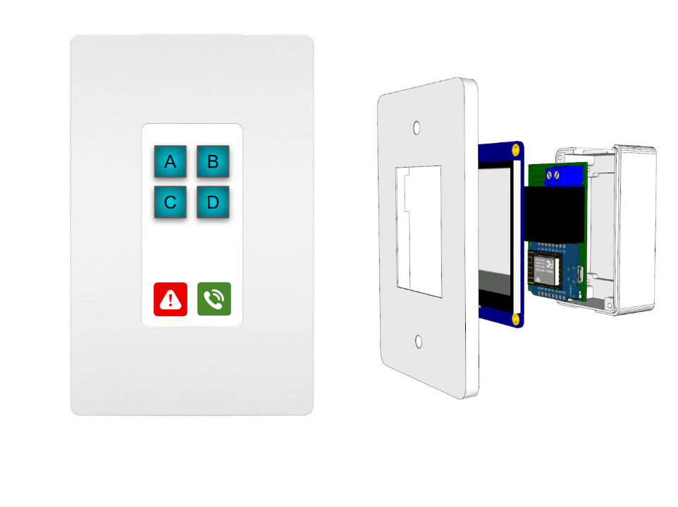

If you think this can be useful for a Case Study, I would really appreciate a shot at it.
I am trying to focus this on helping solve issues with modular notifications for example, for a kids room, toddler school, or elderly facility.
Its a personal project that I do not mind to share.
I currently working on a design that fits in a light switch wall receptacle.
I did the PCB layout in KICAD and 3D printed the inserts.
the LCD are generic 2.4" TFT 240x320 until I find more elegant solutions.
Eventually making the POE a little more sleek, instead of adapters.

Wall Receptacle Touch Screen ESP32 design for case study.
Uploaded as attachment the design, I would definitely document my process with Flowcode for display as I go along.
