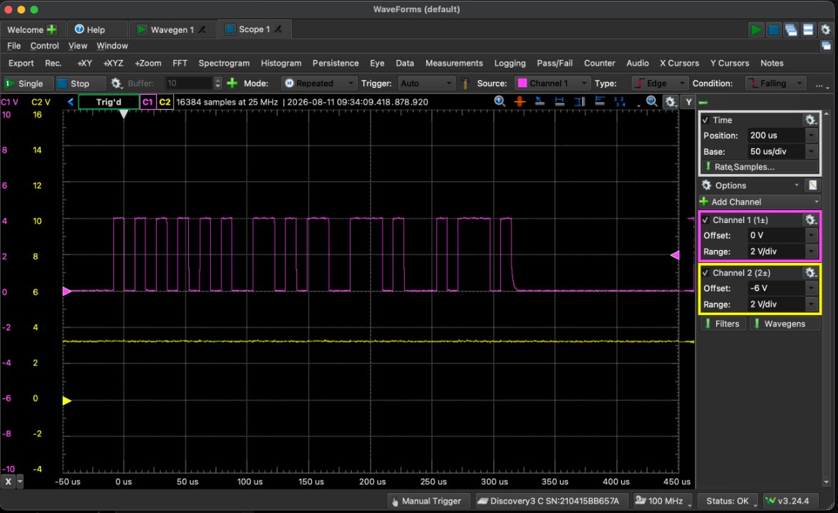

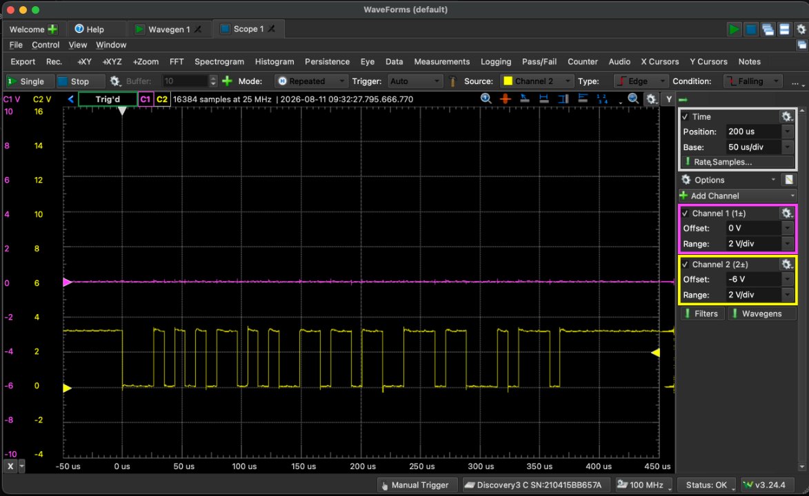

The pink waveform is the waveform outputting "Test" from the PIC18F57Q84.
The second yellow waveform is the waveform outputting "Test" from another device (PC USB-Serial).

Looks like the TX output is being forced into a non-Idle (break) state

The signal looks inverted, but if you analyse the data it looks correct for "Test"
So I think it is in break mode in the inter data gaps.

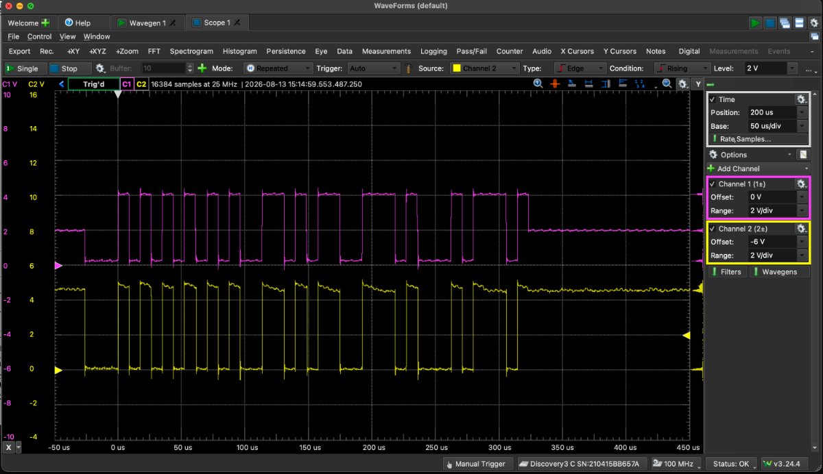

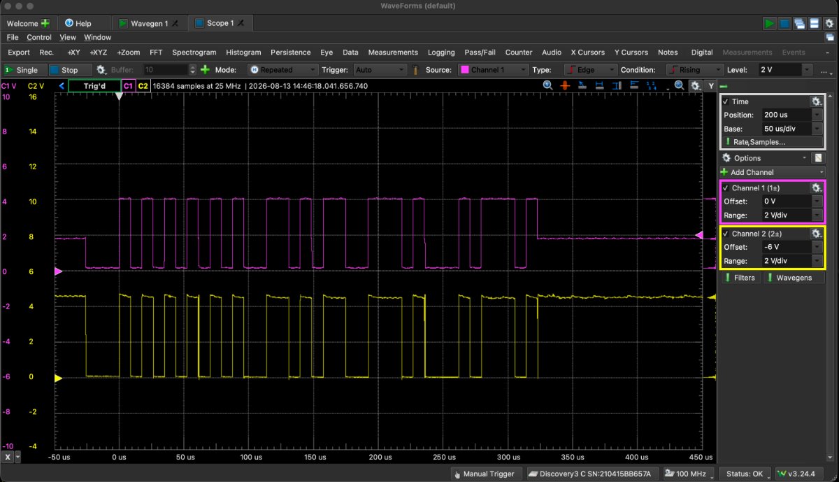

Communication works if the pull-up resistor is changed to 3 kiloohms. It is expected that this result is due to the threshold level. It appears that a pull-up resistor of about 2k ohms is necessary for stable communication.
The pink color is the waveform directly connected to the MCU, and the yellow color is the isolated waveform passed through the TLP2355.
