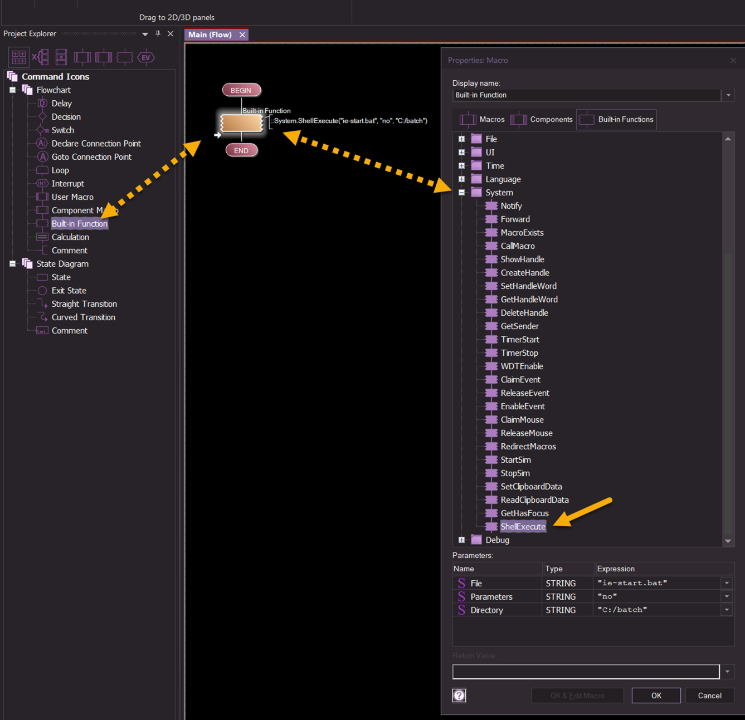

Re: Explain New Functions
Is there also an info about:
ShellExecute - allows external files, websites, etc., to be launched
SerialDLL - GetCOMDetails added so components can report details and make decisions on the connected hardware
Posts: 2007
Has thanked: 300 times
Been thanked: 465 times
Hi Stefan,
The info on the wiki is being updated and will hopefully include the new additions in v9.1 soon. The ShellExecute function should behave like the internal Windows function and there are many references online that should help you use it before the wiki is updated.
Posts: 1277
Has thanked: 245 times
Been thanked: 256 times
Hi Steve
Perfect. I found the shell and it's working nice.
