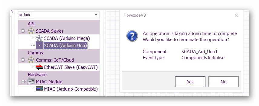

Just trying to load a project that uses the Arduino Uno SCADA component.
On loading the project I get an 'operation is taking a long time to complete' error - and on choosing yes or no - flowcode 'eventually' closes.
This also occurs on adding the component to an empty flowchart (the 'Mega' equivalent works AOK) - after a long (10mins) wait the 2d panel had appeared but FC is unresponsive.

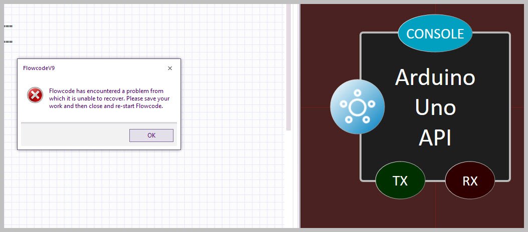

The UNO SCADA component had an upgrade ,Did you do an update on your FC . ?
There is an issue sometimes when placing the SCADA UNO Component FC crash but then closing it and redo it normally solve the issue for me
I am working with this new SCADA component
(1) remove the old component from the FC chart then close it
(2) open up and place a new Component on the panel
(3) if happens as show below close and reopen and try again normally it works

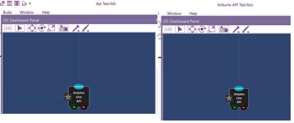

I have made a new Embedded & App Developer flowchart with Arduino API component and they both open for me OK:
Can you post one of your new flowcharts that don't open for you?
