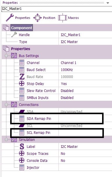

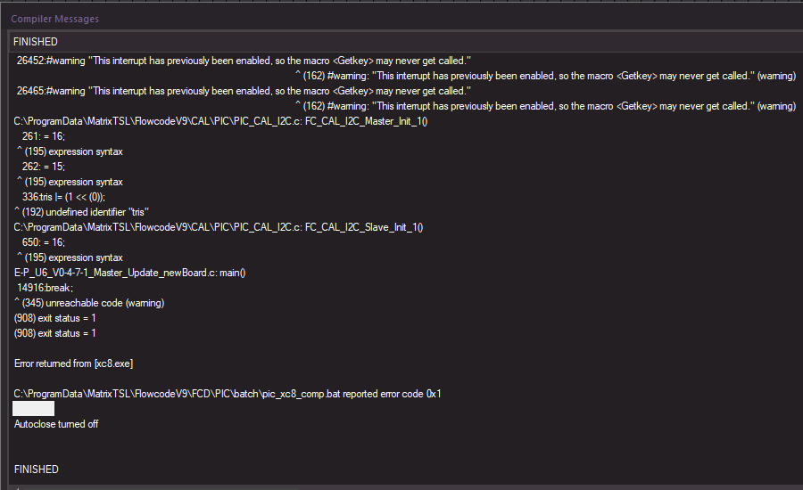

I having a problem compiling my program in V9 looks like something wrong with the I2C Master and slave
Screenshot 2021-06-28 154931.png (47.76 KiB) Viewed 5860 times

Re: I2C fault when compiling
Can you please post a program that causes this error - this will help us to solve the problem.
Looks like maybe one of the connection pin properties are unconnected. I could be wrong but it's worth checking.
Posts: 2269
Has thanked: 626 times
Been thanked: 833 times
This is the problem, there are no pins specified for I2C.

Thanks not quite sure why when you open a program that was created in V7 it dose not open with the same settings like both the UART'S are set to 9600 and channel 1 and now the I2C is not connected. I Now have another error
E-P_U6_V0-4-7-1_Master_Update_newBoard.c: 567: (1250) could not find space (250 bytes) for variable _FCV_01211_CircularBuffer1__DATA
which is strange as the system compiles in V& but not V9
