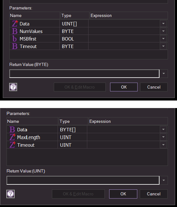

The uart or com component can Send/ Receive Byte Array or Int Array
This sending and receiving arrays is working perfect and it's so simple to use.
And it saves a lot of trouble .
One more question, why is the Byte Array unlimted in the size and the Int Array limited to a Byte size (255) ?
Posts: 2307
Has thanked: 639 times
Been thanked: 848 times
Re: Send/ Receive Byte Array vs Int Array
Hi Stefan,
No real reason, I'll see if we can move that to an UINT too without causing any knock on problems.
