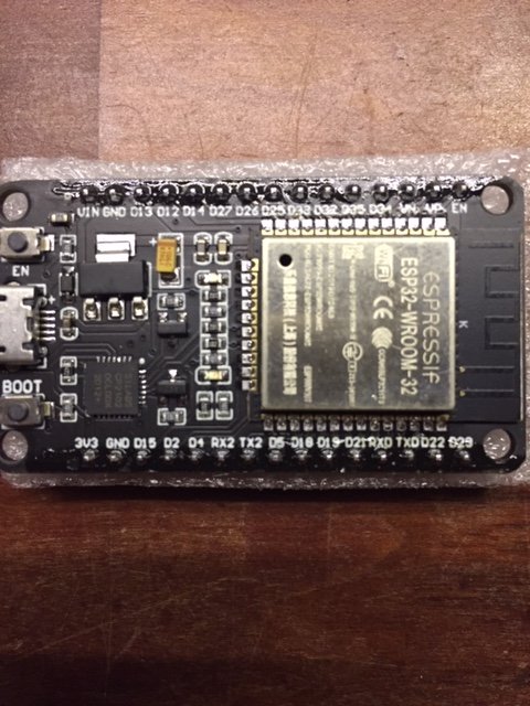

IPlease have a look on this. This is the device I use, is this the correct one?
Jorgen
Posts: 2305
Has thanked: 637 times
Been thanked: 847 times
Re: ESP32 & Ili9341 not working
Hi Jorgen,
Yes that looks fine.
