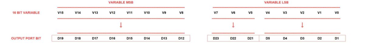

I'mm working with ESP32 DEVKIT.
I will need to count up on a 16 bit variable ( Uint ), lets suppose variable V, and output its contents to portA of ESP32 .
As its bits (numbering) aren't all contiguous ones,
I was thinking to:
output
the Less Significant Byte of variable V ( V0 V1 V2 V3 V4 V5 V6 V7 )
to ( D1 D2 D3 D4 D5 D21 D22 D23 ) respectively .
and output
Most Significant Byte of variable variable V ( V8 V9 V10 V11 V12 V13 V14 V15 )
to ( D12 D13 D14 D15 D16 D17 D18 D19 ) respectively .
like this
ESP32 Unifying non contiguous port bits for output 16bit data (two 8 bit ports)_ _.jpg
ESP32 Unifying non contiguous port bits for output 16bit data (two 8 bit ports)_ _.jpg (26.05 KiB) Viewed 5749 times
I can preview this may imply perhaps some shifting and calculations and probably isolating the LSB and MSB of variable V ,
but I have not a clear view on how to implement it .
Question is :
Can someone put some light here, by giving here some ideas / tips on how to achieve this.

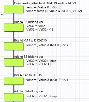

You probably want the output bits to all come on at the same time so we will first do all the rearrangement of the bits before outputting to the port.
First we get the bits from the 16-bit variable and rearrange them into the right place in a 32-bit variable.

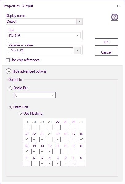

Using an output icon we mask off the bits we want to control using our 32-bit variable.
Here's a project with a macro to take the 16-bit value and output to the port so you can reuse as required.
Convert16-bit to 32-bit port.fcfx
(8.44 KiB) Downloaded 611 times

edit. The problem seems to be to do with your initial writes to PortA, you've not enabled the masking and so all the PortA pins are written to including the pins that work with the device flash memory and this is causing the program not to run correctly.
Removing these initial PortA writes and the program is now running correctly.
