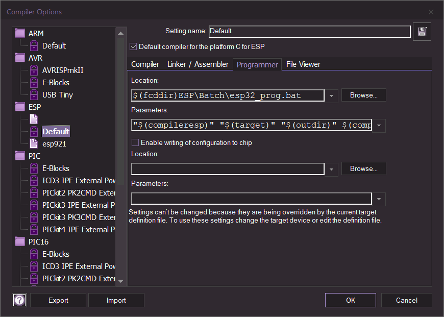

My ESP32 program was working fine until I play with the baudrate for the programmer
For this I made a compiler option ESP921. It's was not working, so I like to go back to Default.
But the default is not working anymore and I can not delet the compiler option ESP921 anymore
But the worst is, it does not flash correct anymore...
This is now: It's not longer flashing"

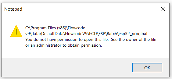

It looks like it's a build step that's failing not the programming step.
[3/625] Performing build step for 'bootloader'
FAILED: bootloader-prefix/src/bootloader-stamp/bootloader-build bootloader/bootloader.elf bootloader/bootloader.bin bootloader/bootloader.map
Did you edit the esp32_build.bat file at all? If you did then you should be able to revert back to stock using the library updates window in Flowcode.

Re: ESP32 not flashing anymore
No I did not....I mean I can't
What I did is add Compiler option. I add two settings. How can I remove this two settings?
I reset the lib in the global option and updated the Lib again. This did not help
