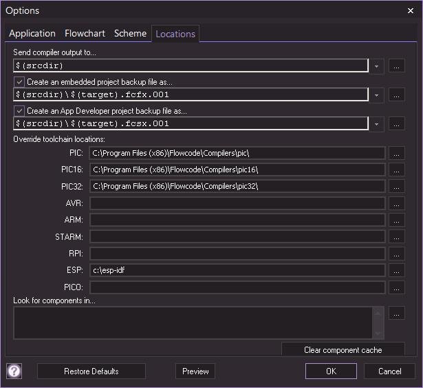

Can you check if there is a directory esp-idf on the root of drive C
It might be installed on your desktop? (e.g. C:\Users\xxxxx\Desktop\esp-idf)

Hi Leigh,
Thanks for this, I have checked and there is a folder there and some files inside...

There are two folders that are installed during the toolchain installation. The ESP-IDF folder and the ESP-IDF-Tools folder.
The folder you are showing there is the ESP-IDF-Tools folder but you need to be pointing Flowcode to the ESP-IDF folder. If you set both folders to be in the same place then it might not have liked that.
Maybe uninstall and re-install the toolchain and make a note of the directories you select.
I have the following directories for the toolchain but they can be just about anything as long as there are no spaces in the path.
D:\Dev\FlowcodeV9\Compilers\esp-idf
D:\Dev\FlowcodeV9\Compilers\esp-idf-tools

Hi Ben,
Many thanks for clarifying, I was doing something wrong, I now got the 2 separate folders under c:\dev and compilation works perfectly well!
Thanks again!
