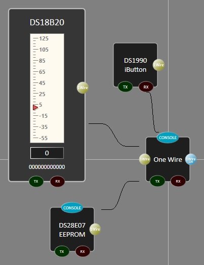

Further to Medelec's post.
The DS18B20 component requires the OneWire component which hosts the bus and has the pin connection properties you're looking for. The OneWire component is available under Comms -> Comms: Interface.
It's been done like this to allow for multiple different types of device to be hooked onto a single OneWire bus and to keep things as simple and efficient as possible.
For example.
For example.

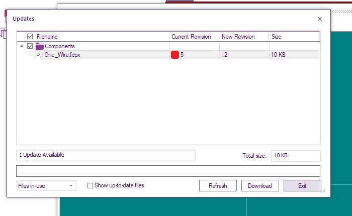

Hello
If you just add the onewire component and down grade it to version 5 that might solve your problem.
Version 5 has DS18B20 commands built into it.
Its worth a try.
Or I think maybe the onewire component is not in the version you have. You might be stuck then.
Mark
Its worth a try.
Mark

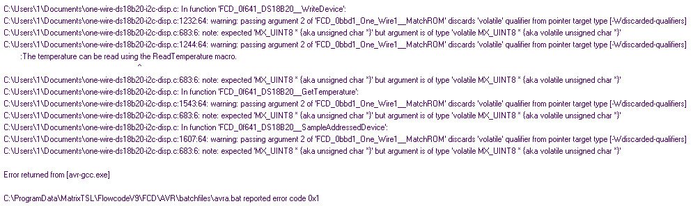

Re: DS18B20 connection
Can I see example with Arduino Nano + OneWire + DS18B20 please?
This combination just give errors when compilied. May be I do something wrong?
Hi.
Screenshots don't help, unfortunately.
Have you made sure you have downloaded the latest version and assigned one wire component to a suitable pin?
If you have then can you post your flowchart and .msg.txt file.
