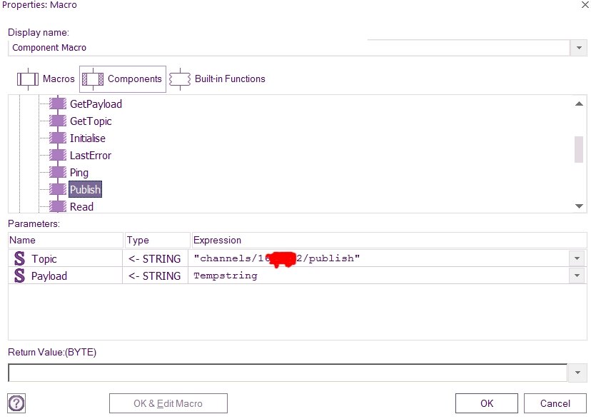

But where do I need to enter the write key? The "topic"?

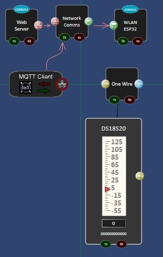

The setup I have right now is this:
So I guess that now it's as simple as publishing a topic and payload?
Does anyone have a working example for me to investigate?.

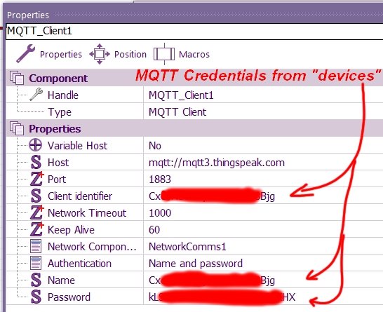

And using these settings:
I still don't see the data I send appear on Thingspeak..
Am I using the right credentials?
Any help is welcome..

Since then I think Thinkspeak have limited connections to secure ones, I don't know if this applies to the MQTT service. If it does then the Flowcode component would only work on hardware with secure network support, such as Raspberry pi.
I don't think you have mentioned what you are running on?
I would suggest adding some debug code and check the return values from the various MQTT component macro/functions. Hence determine if it is the initial connection or the publish that is failing.
