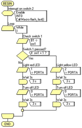

The flowchart sequence:
- Check if switch 1 is pressed.
- If it isn't, make the red LED flash slowly.
- If it is, make the yellow LED flash slowly.
- Go back to the beginning and repeat the process.
- Whenever switch 2 is pressed, immediately make both LEDs flash quickly ten times and then go back to the main program.

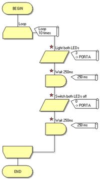

- The next task is to create the ISR. Click on the 'Create New Macro...' button.
- The 'Create a New Macro' dialogue box opens.
- Give the macro the name "flash_fast".
- Click on OK.
- In the 'Properties:Interrupt' dialogue box, click on the 'OK & Edit Macro' button.
- Create the flowchart shown opposite for the macro.
- Sending value '3' (=00011 in binary,) to Port A switches on both LEDs.
The main flowchart
Your flowchart should now be set up to resemble the image below:
