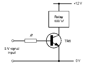

A manufacturer of electronic switches has asked you to advise on the design of the transistor switching circuit shown in the figure. If the transistor has a common-emitter current gain of 200 and a nominal base-emitter voltage of 0.65 V, determine:
# The value of collector current required to operate the relay # The value of base current required to operate the relay # The maximum value of the base resistor, R # The nearest suitable value of resistor for R taken from the E12 series # The power developed in the relay coil when the relay is operating # The input signal power when the relay coil is operating. (:nl:)(:table style="clear:both":)
