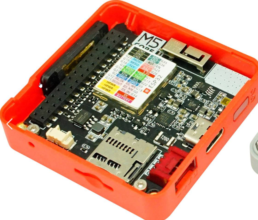

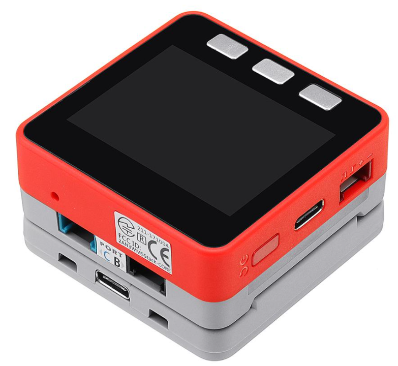

I use this module with FC10.
Works very well and is already in a housing with battery and USB-C connection for charging and programming.
Some built-in hardware like switches, display, micro-sd card, Bluetooth or IMU also work very well with Flowcode 10.
In addition, it also has various ports with these small common Groove 4-pin connectors.

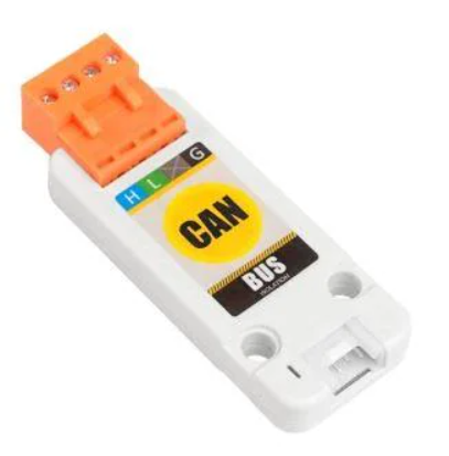

You can connect a CAN module there, for example. But I don't know anything about CAN (yet).
The module is built in such a way that you can also draw your own board and install it.
I would also give you a little "hello world" programme if you like.
K007-V26 M5Stack | Mouser
https://www.mouser.com/ProductDetail/M5 ... XB7w%3D%3D
Modul with a dockingstation (included)
Modul Open
Can Modul:
U085 M5Stack | Mouser
https://www.mouser.com/ProductDetail/M5 ... kyog%3D%3D
