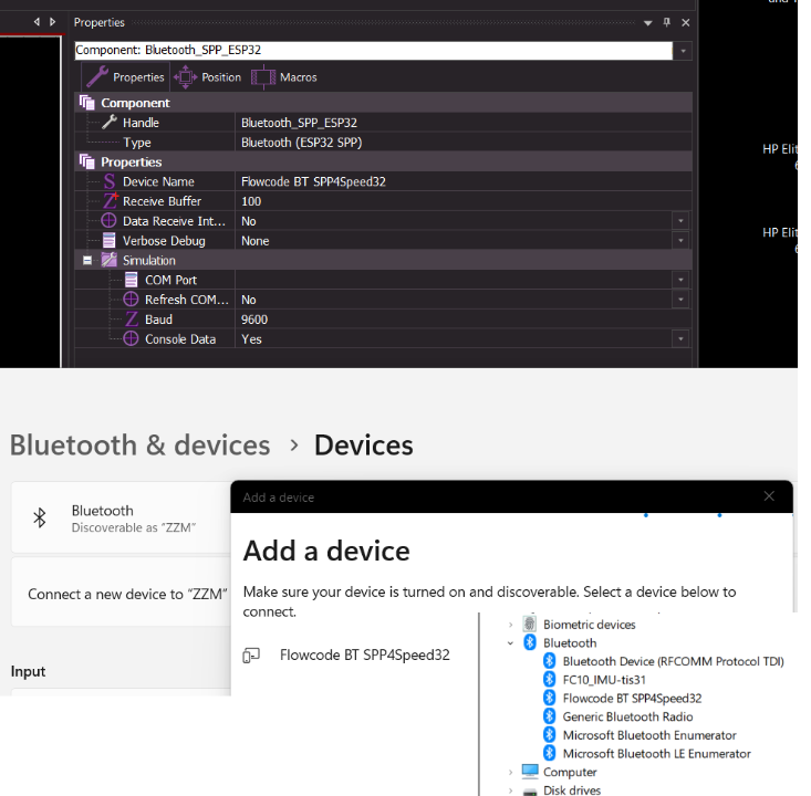

Hello all
just trying to start Bluetooth SPP on the chip esp32 wroom-32.
the copiler runs through without error message and nothing happens.
Apparently I have to change something at some point to get bluetooth to work. no cell phone can find the chip as a participant. why is there no batchfile offered here to make this change. I use FC because I just want to program graphically and can't do anything else. if I could program in c, I wouldn't need fc.
my old problem "Problem with the interrupt Pic32mx150F128b" is simply not followed up and solved. then i try to cleverly work around my problem with the esp32 and i have the next problem on my hands. somewhere in forum 2022 it was apparently solved once (reprogrammed by hand). but it still exists, after months and countless abdates. I have reinstalled everything once and am glad that already times when copilieren no error comes. and then you have to find out does not work. I do not want to hear now man can bypass the error with HC05. so now you're asked. please a description for a beginner. :roll:
greeting SpeedPic32
Translated with www.DeepL.com/Translator (free version)
ESP32SPP.fcfx
(10.11 KiB) Downloaded 1040 times

I've pushed a change to the library system for the ESP32 build batch files and FCDs.
The new batch file once run using compile to hex or compile to target should generate a new file called "menuconfig.bat" inside the project build directory. For example if your Flowcode project is called Test then in that same folder will be another folder named test and the menuconfig.bat will be inside that folder.
If you double click it then it will now take you directly to the menuconfig tool that will allow you to configure the settings for the project in a graphical way. It looks like what we were trying to do was working but then after compilation the config file was being overwritten and so maybe better to use the inbuilt IDF tool rather then trying to be too clever about things.
On running the menuconfig.bat batch file, the Bluetooth settings are inside the following menu.
Component Config -> Bluetooth ->
Then the Classic Bluetooth and SPP also needs enabling here.
Component Config -> Bluetooth -> Bluedroid Options
Press Q to quit followed by Y to save.

Re: Bluetooth SPP 32 no function
Hi Ben, Hi SpeedPIC32
I tested and it's working fine with the batch file and the modificationen in the config.
Creat a new project and it's working
